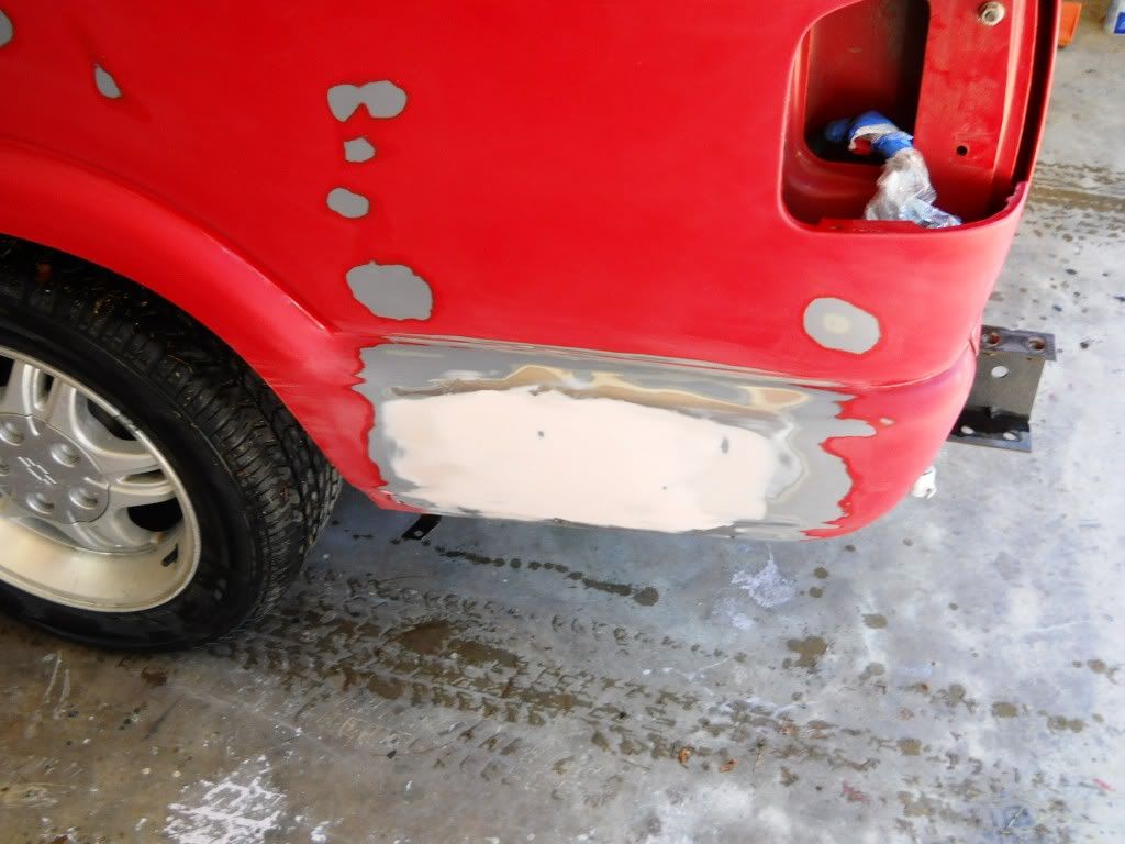

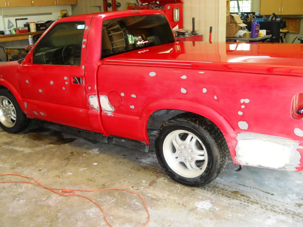

Got some Zen bucket time on the Home Depot bucket - took a minute to appreciate the nice day... Found the long board and a decent supply of sandpaper. Took down the Bondo, added a second layer, took it down and feathered, finished with a skim coat of two-part professional putty (yea I am trying to pass).
Came out respectable - smooth, feathered and better than a big dent.
I also worked the smaller area by the gas door. It is OK too. Next came a very good scrubbing over the entire truck. I used purple cleaner and a wash cloth on the right side and purple clean and a Scocth-Brite pad on the left. I sanded all the chips with 80, 220, and 400 feathering it out according to the chip size. Then washed the left side again with a new pad and plain water - towel dry. Now I am getting in the ball park at least!
Will primer the Bondo areas with two-part high build primer - light sand the primer then a long slow scrub on the back and left side with a fresh Scotch Brite Pad - I got a ten pack at Pep Boys - then she goes into the yet to be erected paint booth for final inspection and a wipe down with degreaser.
Just as I thought I was getting somewhere I remembered the pile of bumpers, flares, and grill. That stuff all needs to be scrubbed, sanded, prepped and sprayed with plastic prep (on the raw stuff). OK - add another day on the fix'n to get ready to paint part!

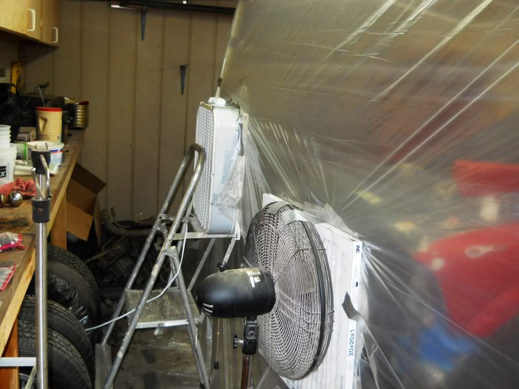

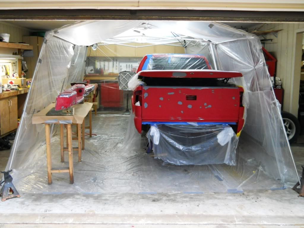

Here are some photos of the paint shack - before I put the "door" on the end. Two fans barely give it positive atmosphere pressure - I think a good fart would do about the same - but it is the most I have ever done to paint something.
You can walk all the way around the paint shack - a little crowded in the back but plenty of room on the work bench and tool box sides. I am hoping to leave the shop door open for ventilation but can close it if unexpected wind kicks up.
Two water separators on the air lines - 55 psi tank pressure gives me 4.5 CFM - borderline but I am not about to buy another compressor so I will do panel, pause, panel pause - the way I did boats. Not the best, but it is reality for most of us home shop guys.

Nice booth, figured 2 running fans would give more air pressure.

The black swivel fan is more powerful than the $16 POS Walley World Chinese crap fan, but even so, you can barely feel air moving ten feet away - the filters really wack the air volume. In hindsight I probably would get the cheap $2 filters instead of the medium $5 filters - I was really trying to keep bugs out more than a micro dust bomb anyways....
I saw a booth like this online and there were three fans - which at first I thought was overkill. If you have time visit some garage sells - get three cheapo box fans - set them up high on the wall.

I'm intrigued by this paint booth. I have a two car garage and wanted to do this very same thing in there to paint my truck. The two issues that people hounded me about were paint particles getting into the fan motors causing a fire/explosion. Though fans pushing the air seems like it would prevent that (I was thinking puller fans).
The other issue is paint going air born out of the garage door and getting overspray on my other rides on my neighbors rides.
Are you totally sealing up the open end in the pic or are you leaving a vent in it? If a vent, let me know how bad the overspray is coming out. I remember the overspray was pretty decent coming out of booth at the boy shop that I worked at.

The open end has two simple hanging sheets of plastic free to blow around - if I get overspray on my house and cars then I wasted time with HVLP and will throw them in the aluminim recycle pile! About the flash fire from paint fumes - yes that is a possibility if I get enough concentration of flamable fumes. I am counting on those fumes not being able to move upwind through the filters and then concentrating to the point they can ignite. More than likely I would pass out from the fumes first - and thus stop spraying.....
Home/shop stuff is a compromise...but since the Chicken Ranch body is ten feet from the shop door I will look it over to see what overspray gets out and let you know....

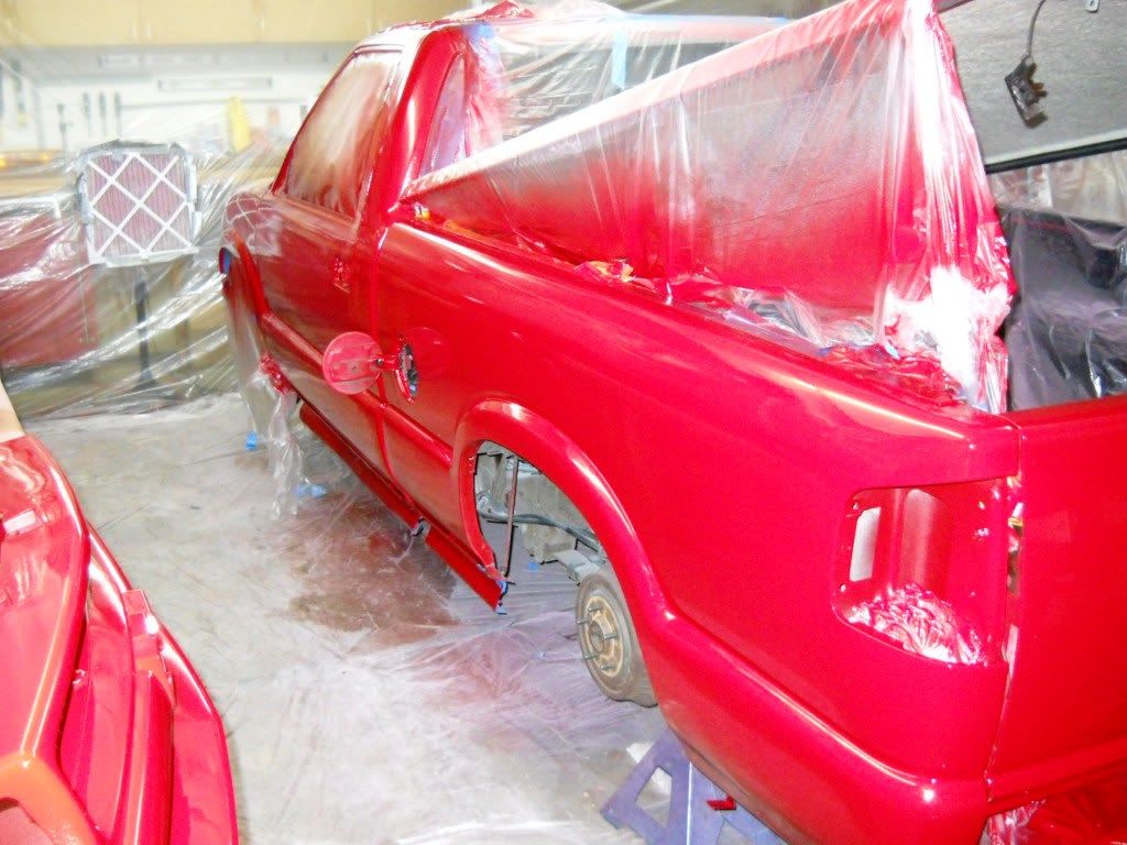

Here are some right after painting photos. Looks like the red is too much for my camera!

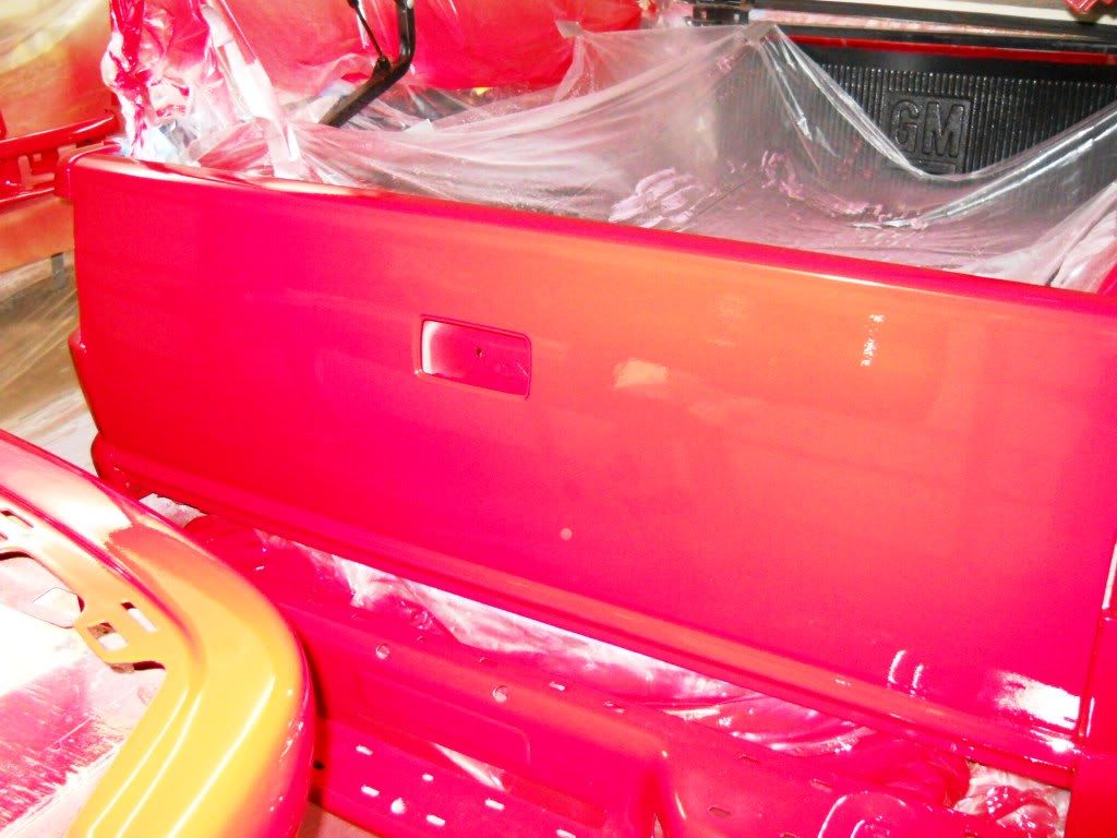

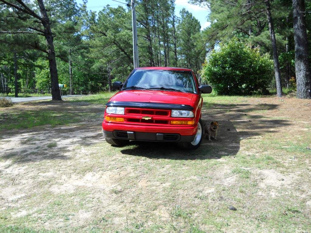

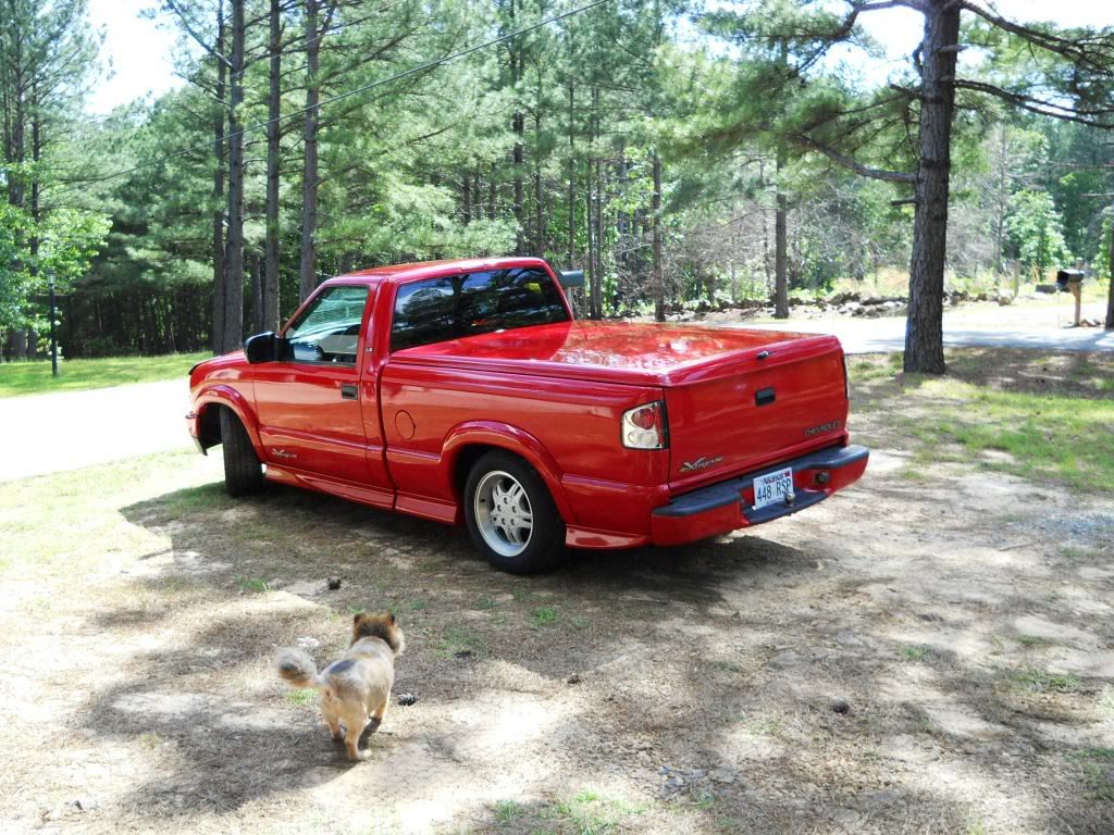

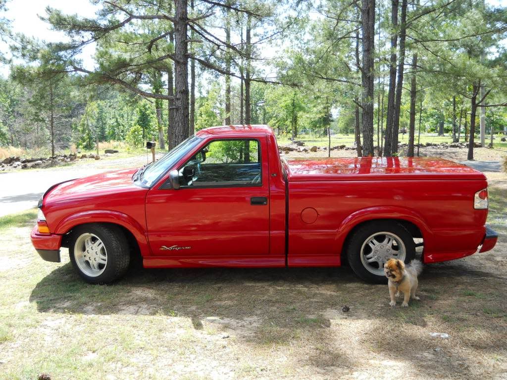

After 1000 grit in the rough spots - 1500 and 2000 everywhere else I used the $19.95 car polisher I already had to buff the paint. Mirror glaze cutting polish (85) and Mirror Glaze Polish (205). At first it was not going well at all - then I read some more went to Walley World and got a couple yellow foam pads for the 10" polisher. What a difference - with the foam pad it only took about 14 more hours to get the paint worked down good enough for a driver.
I also did a final polish on the whole truck so that took some time. Once the body was OK I spent another couple of hours putting all the stuff back on. Am happy with the results. Here are some photos - in person it is about what the average quick turn body shop would roll out - which is really all I could every ask for at home. The dog is Roy Rogers - he wanted to go for a ride - real bad. So my wife and I made a little run - A/C just barely managed a puff of cold - she's a leaker - whatever - THAT is not a problem!
Side View
Truth angle - not bad for home painting
Wish I would have had another pint - a little thin on the tail gate!
Xtreme front with a stock dam - I know - but I don't have to worry about ripping the dam thing off every time I go to lunch at work...
This is exactly how I plan to shoot mine in a couple weeks.... I have a couple addtl questions for you:
-why keep the fans high?
- do you think you would have seen better airflow with 1 fan pushing air in, and 1 fan exhausting air out?
- what mil thickness plastic did you use?
Old 05-18-2012, 06:36 PM   #282
Age: 59
Join Date: Oct 2010
Posts: 147
Location: Cabot, Arkansas
Re: Chicken Ranch - S10 Rat
I wish I had a profound scientific base answer for you - but the truth is I was afraid the narrow cheapo box fan would fall over so I taped it to a step ladder. It was only a coincidence that it was roughly the same height as the other stand up fan. If you floor is not real clean - better to have the fans up. Also if I did this again I would buy the cheapo filters - they let in more air but still will keep bugs and floaters out.
