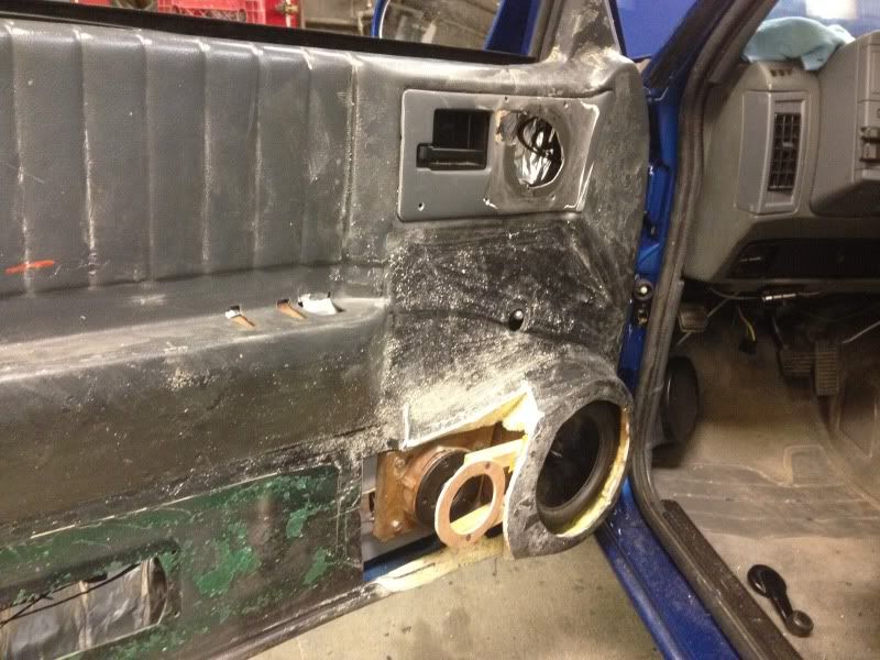

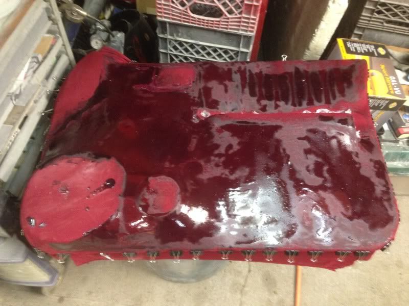

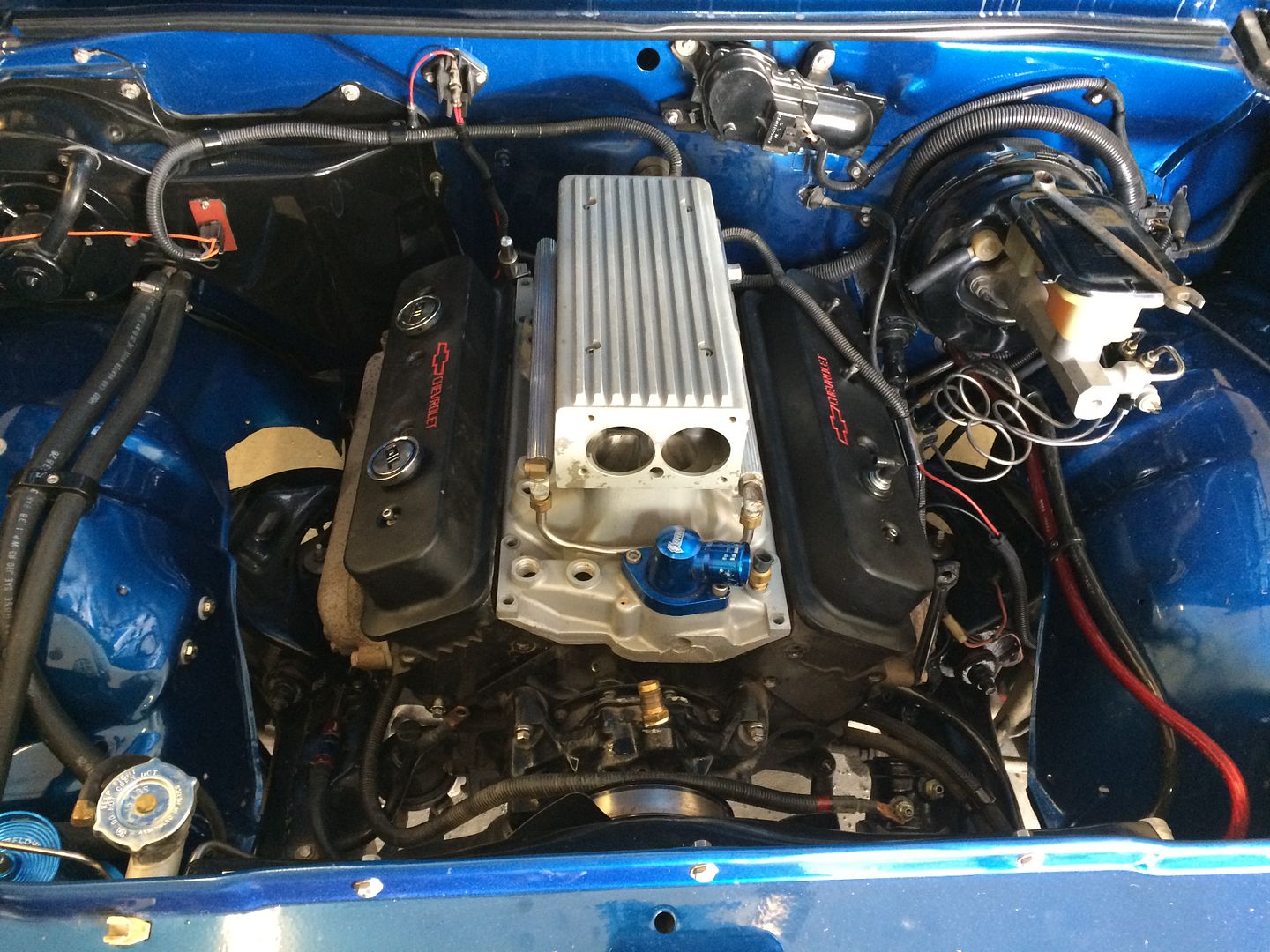

Been awhile since I've been on here. I ran into problem after problem with the engine, first the carb was flooding so it took me a week to figure out I had a bad float. Fuel psi was to high, so I had to get a fpr and fought leaky fuel lines plumbing it in. Changed my oil and had no oil psi, I'm using a canton pan, canton dipstick and there recommended pick up, so I assumed I could go off of the dip stick notches on their stick. Nope, I'm supposed to use my stock stick to find the level and mark the canton one. Got that figured out today finally.
I will say it is running much better, finally getting to enjoy all that power.
Started on my door panels, got a layer of glass on them, need to do one more layer then I'll finish it up.
Only pic of the fpr mounted that I have.
Swapped out the tweeters and got new mid ranges

Somewhat, the fuel pressure regulator made a big difference. I really need a open place to test and tune it where I cant be bothered by the police.

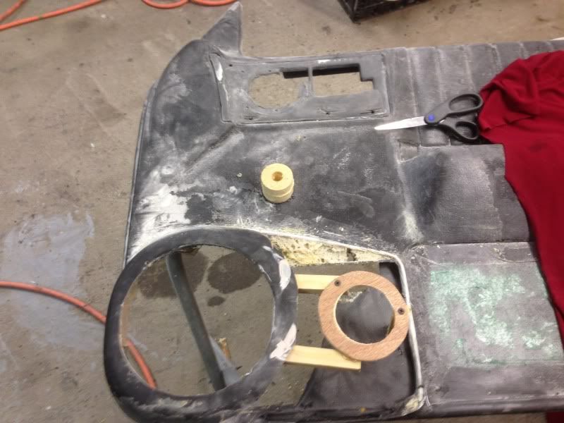

I got the driver side panel ready for vinyl.
I won't be spending as much time on the truck for awhile because I've started a new project,

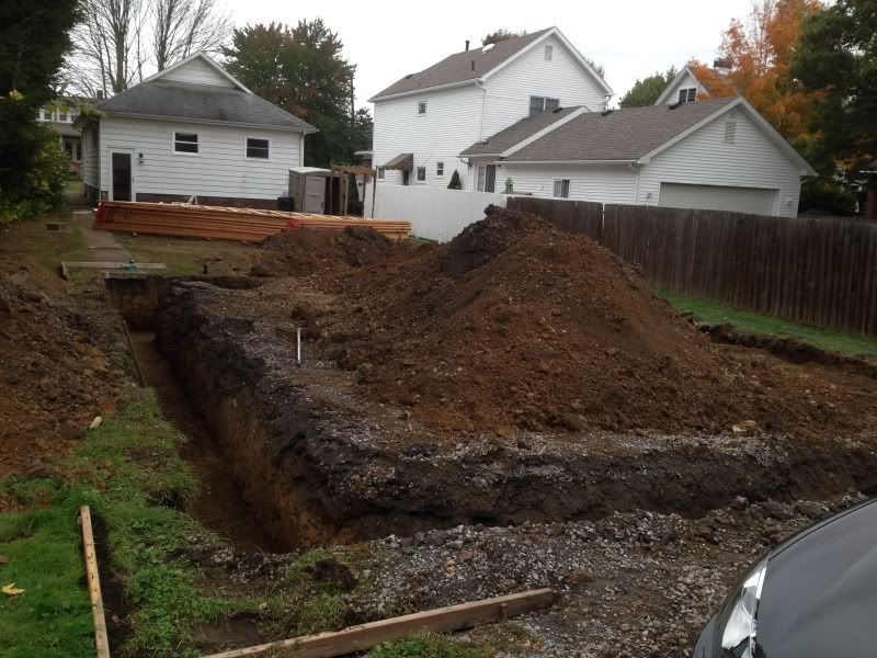

post #421 of 437 Old 10-15-2013, 06:48 AM Thread Starter
White96ZQ8's Avatar
Location: Moundsville WV, 26041
Posts: 1,612
User is: White96ZQ8 is offline
Re: 91 Street Truck
28' x 36'. That's just for the footer, it's pretty deep on that side because the yard is slopped a bit.

Did some work to the passenger door panel tonight,
I'm going to use the 4 way stretch vinyl on the door panels. It doesn't match to great with the other vinyl I used, but if I like it Ill cover everything else with it.
I'm getting a Porsche 914 Saturday for parts. I think its time I start a build thread for my ghia.

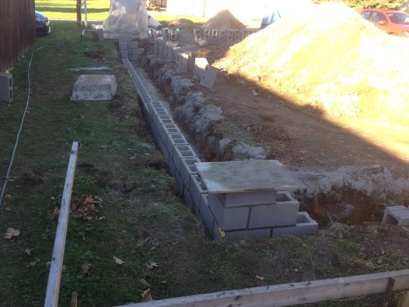

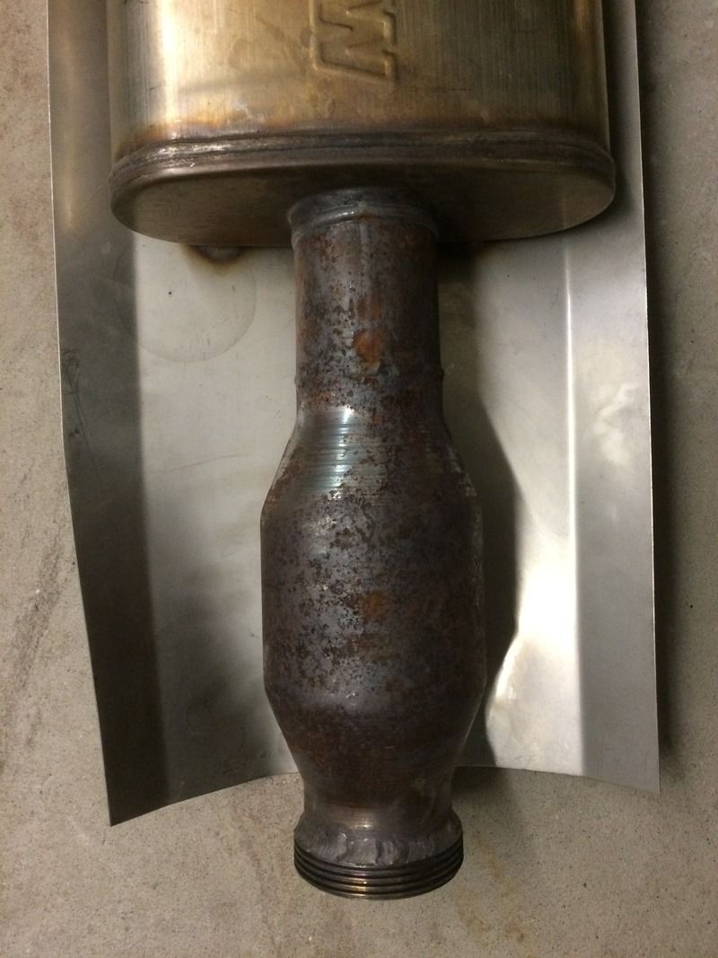

Newest addition to the family,
I'm picking everything I can from it and scrapping it.
Progress on the garage,
Nothing on the s10 though, I'm out of resin.

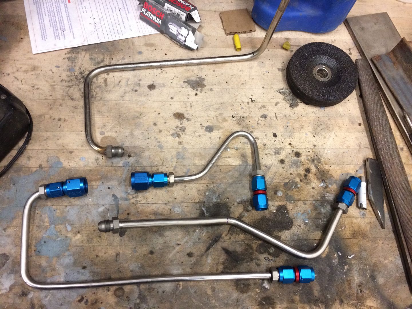

Thanks! Yeah I was on here often a few years ago. I kinda moved on to other forums, but I still come back and check in. Now that I can legally drive my truck I will prob be getting on here more.

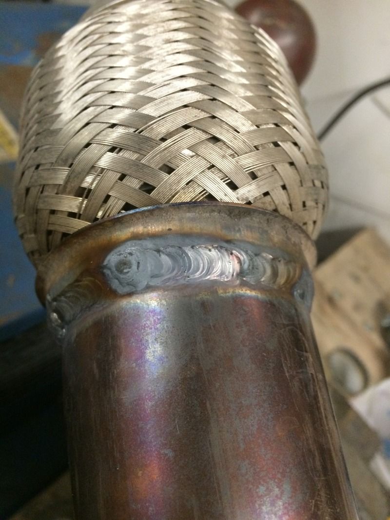

I welded some flex pipes into my exhaust. Also I am considering taking the cats out. I don't have to worry about inspections anymore, and they look like crap. "Stainless Steel" magnaflow cats. I don't recommend them, this truck had less than 100 miles on it and has been stored in a heated garage in the winters. I contacted magnaflow, they are past their warranty, but I think it's pretty bad how they look now.
My first attempt at tiging stainless exhaust tubing

Been over a year since i posted on here, Ive decided to go to efi. Holley stealth ram,Lingenfelter 1000cfm throttle body 36-1 crank trigger, hall effect sensor, LS coils, MS 2. Im tigging all the AN fittings on to the stainless hardline.

Looks good, man.

Those lines are gonna be perty

that is a pretty engine bay!
