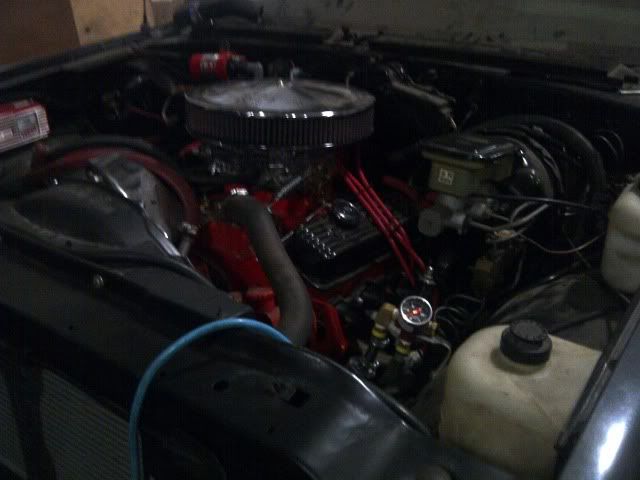

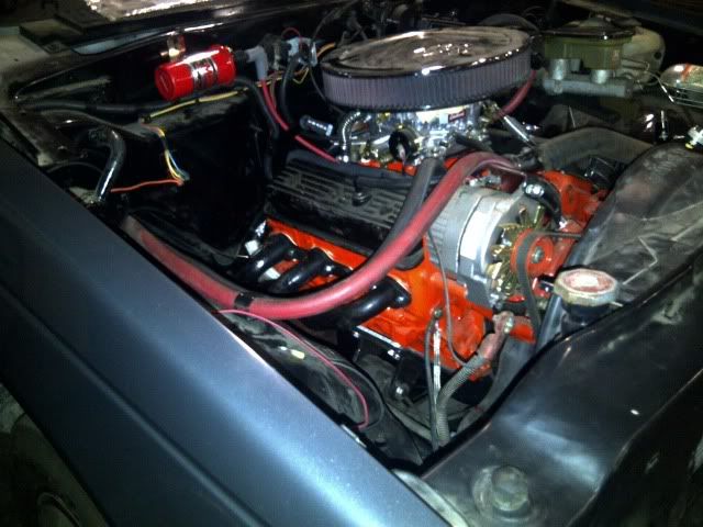

Onto pictures.

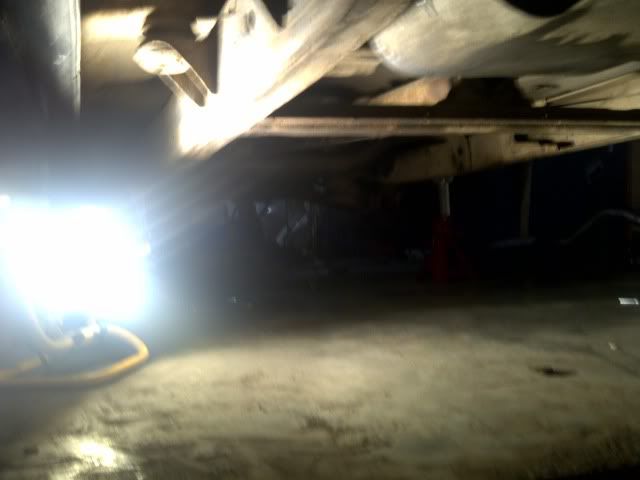

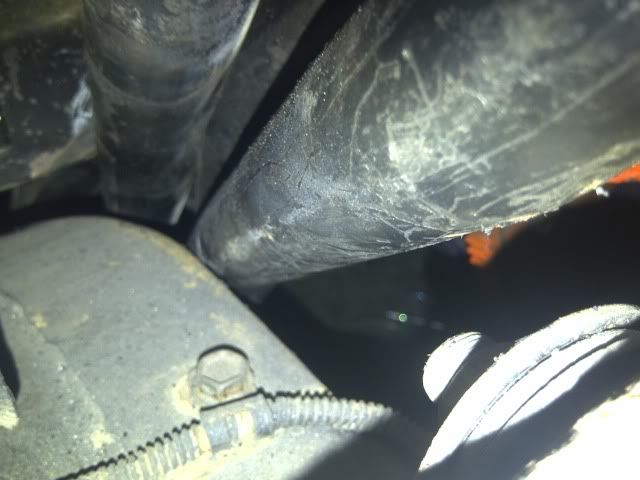

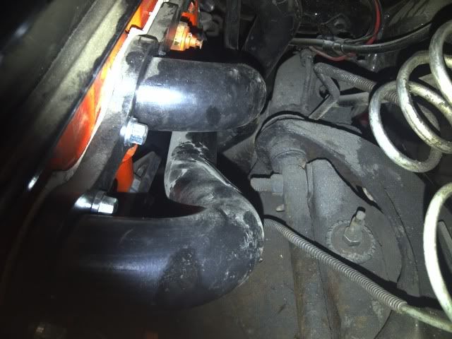

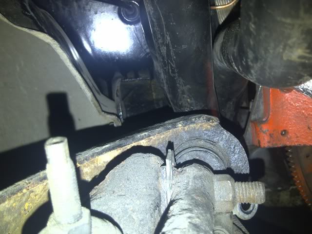

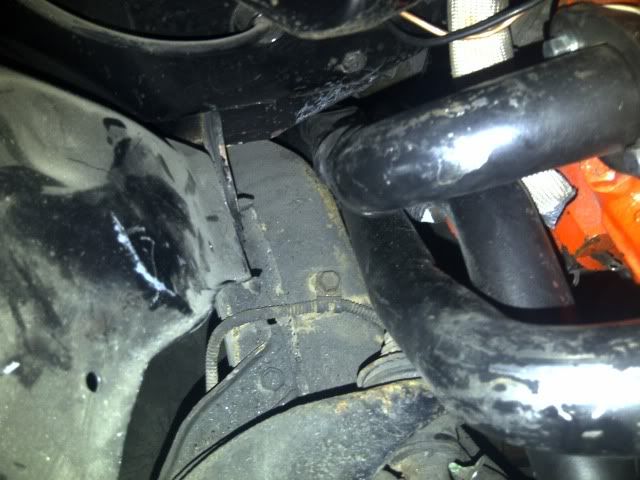

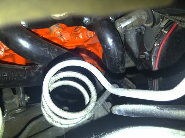

Header clearance is a giant f--k you. Hedman claims it is meant for the 1982 - 1996 4.3L apparently it works for all vehicles without having to modify the header and steering.
Well, didn't work. I think the headers are actually built for a 1989 - 1993 S10 with a 4.3L in it factory.
Headers did get modified on the passenger side to clear both frame rail and firewall/floorboard. Steering is being modified to clear the header.

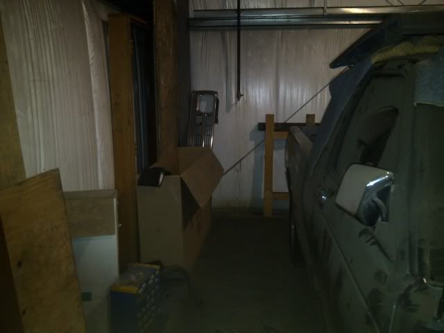

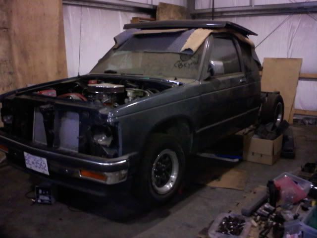

Tomorrow will be doing the upper fan shroud modding. Got a bracket, just a piece of steel. Will paint it black, going to pop-rivet it onto the plastic shroud, and the bolt it down to the core support. Then the shroud is done. Connect the trans. lines, replace the TV cable, and throttle cable, raise the transmission 1/2" to level it out with the front. Was at 1/4" now has 1/4" spacer plates on the motor mounts. Also got the much needed u-joint for the steering. Still need the intermediate shaft...
Once this puppy is out I'll be making a wall to go around the truck, and the '89 will be in there being stripped right down.(Project thread will infact be bombarded with updates pretty much every weekend when there is something to be done. Aweh yeah.)
Seats need to be replaced in the '88 after it's all said and done, of course.

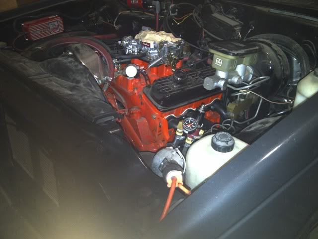

Oil sender is finished. Attempted to pre-lube and was turning the shaft, but no oil came through the rockers. Have 5L of oil in the engine at this moment. Thought there wasn't enough, but.. There is plenty. Nothing is blocking the screen...
Time to pull the pig out again. Guess with it sitting for too long, the shaft must have been stuck and with using the drill to pre-lube the engine it must have broke off or something... This truck, is not going to be out next weekend.
Which then leaves me to just do this..

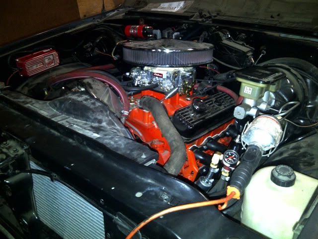

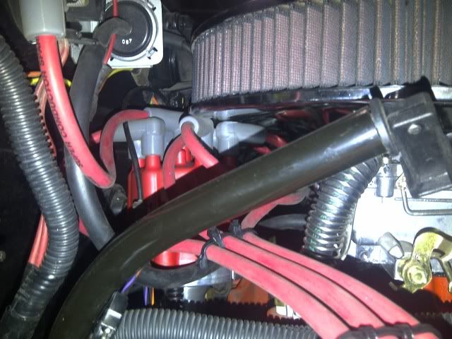

Figured out why the engine wasn't oiling correctly. The shaft made for oiling didn't have the little cup/cuff/whatever at the bottom, so when it started to spin the sender, it turned off.
Looked at the MSD distributor and the old H.E.I. distributor shaft(what was used to turn the pump) and noticed it..
Here is some more pictures.
Seems like the filter and wires are touching...
Tom.

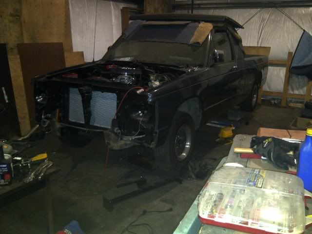

Anyhow, truck's been on the ground and is running. However with the snow flying soon.. Truck's not going to be driven around, until march.

4.3L has been scraped.
Timing was out(way too advanced), detonated and pretty much destroyed the engine. Going to be getting a crate engine now.
Anyhow, I picked up some new rims. 15" new tires, 215/60R15(front), 245/60/R15(rear) painted darn close to body colour... Really close.
Gave her a quick wash as well..

http://i572.photobucket.com/albums/s...0823-00494.jpg
http://i572.photobucket.com/albums/s...0823-00496.jpg
http://i572.photobucket.com/albums/s...0823-00499.jpg
