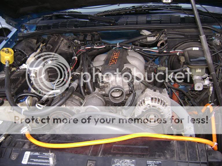

Heres a shot of the engine bay showing how I set it up in there.
The inlet filter isnt on in this pic. Didn't have one at the time, I wanted one with 1/2" pipe thread.

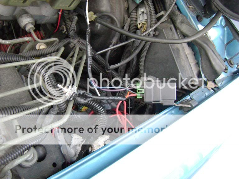

the switch and relay, I have the 20A breaker burried in the wiring in there.

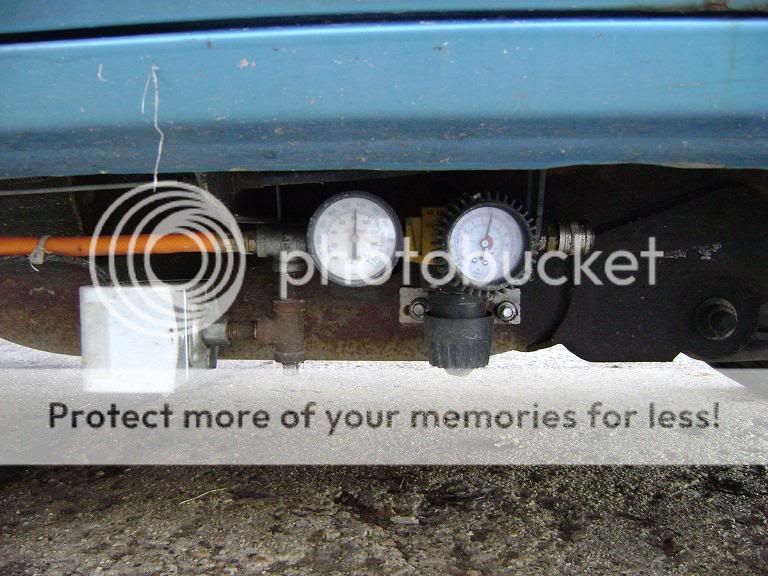

and the presure switch, an air guage for compressor side presure, then the regulator and a guage for tank side presure, and finally a quick connect for my air tank which has a blow-off valve.

Yes, but you don't have to worry about the oil after the compressor, if anything, it will help in the lifetime of your tools. But on air systems, you don't want the oil in the lines. Pretty neat setup, although I don't like where you mounted the gauges, looks like they'd be prone to be hit with rocks etc.....

ya they are in a bad spot but I havent hit anythink with them yet. anyways I am putting the steup in my truck after I get it lifted.
