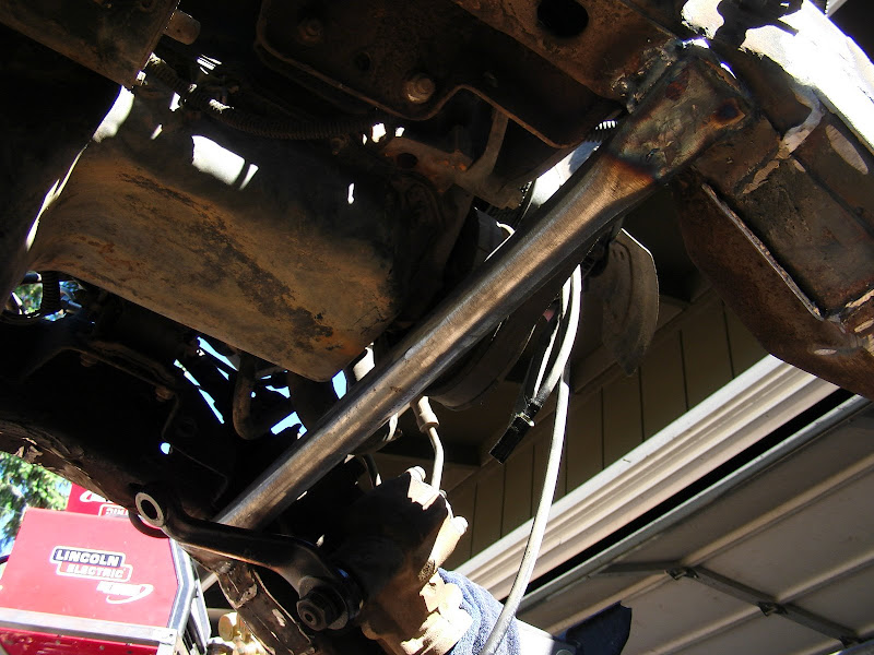

just make sure you cut the stock one off last.
this is the one i made.
Old 04-21-2009, 11:13 PM   #34
96superflow's Avatar
Join Date: Jun 2008
Posts: 722
Location: Moyock/Greenville, NC
User is: Online
Re: Sas Info
Thats awesome, i will definitely do that. If you don't mind me asking, Donahue, What did you make yours from, and how did you make your flat spots? i was thinking of doing something similar, but putting it in-between the frame-rails.
And would you all recommend going ahead and doing the astro steering box swap?
Old 04-21-2009, 11:23 PM   #35
3 Leaf Fab
Donahue's Avatar
Posts: 3,880
Location: Springfield, OR
Re: Sas Info
mine is just .120 wall HREW tube, 1.5" diameter. i made the flat spots with a BFH and a brick
i like mine because i can pull my oil pan without touching the motor mounts and it clears my steering and everything else.
i would recommend installing a crossmember under the engine in addition to the sas crossmember.
only do the astro box if you move the axle foward. you can always try it with the stock box and get the astro later.
i have the astro box in the picture, but with the arm flipped 180*. i am also using the ford pitman arm i mentioned earlier.
wouldnt that make your steering back wards?
Old 04-22-2009, 02:02 AM   #37
3 Leaf Fab
Donahue's Avatar
Posts: 3,880
Re: Sas Info
yes

He ran his steering behind his axle, which, if im not mistaken, would allow it to be correct again?
Old 04-22-2009, 11:28 AM   #39
Fvck New Jersey
Tim99Zr2's Avatar
Posts: 7,535
Location: Reynoldsville, PA
Re: Sas Info
hmm. i see. that correct donahue?
Old 04-23-2009, 08:21 AM   #40
3 Leaf Fab
Donahue's Avatar
Posts: 3,880
Re: Sas Info
yeah, my drag link comes in behind the axle, not in front. its like i have a double negative.
