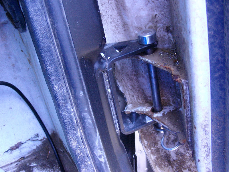

its really simple, i just removed the bushings in the door hinges, and drilled the other holes to 13/32". then i used a piece of 3/8 CR rod with a set collar on one end and a pin on the other. its a little sloppy when the door is open but solid when its closed. the sloppiness is nice for installing the pins, otherwise it would be a hugh pain to line up.

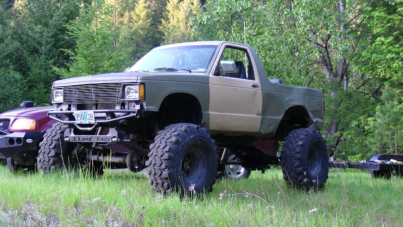

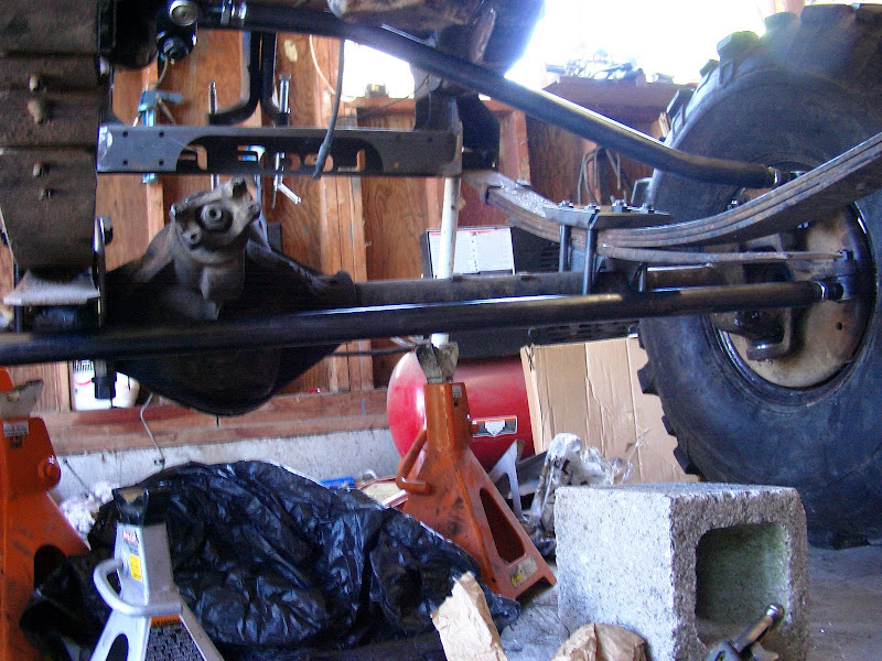

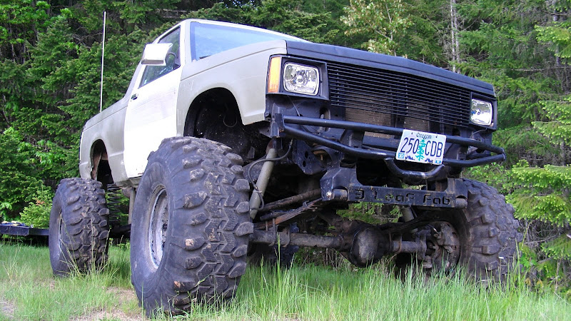

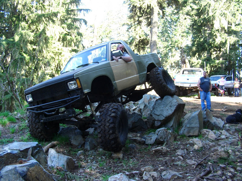

3 Leaf Fab
Donahue's Avatar
Posts: 3,880
Location: Springfield, OR
Re: 89 SFA buildup for rocks

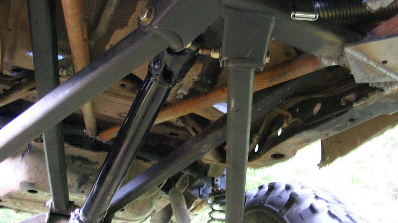

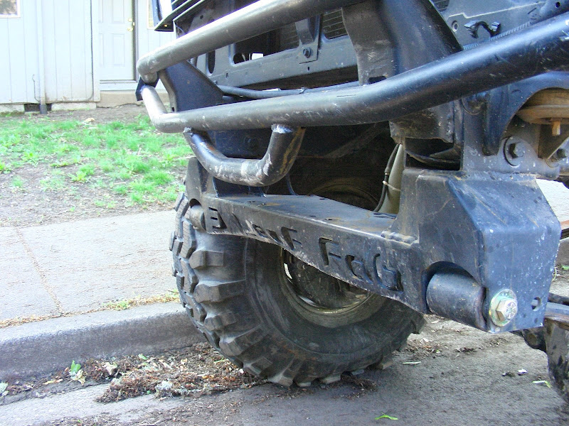

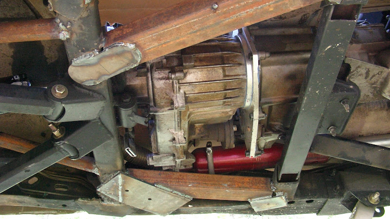

ok, some pics as promised. i dont have all the ones from the last day, they were on my buddies camera.
the current configuration:
notice the sweet unpainted doors
some ghetto late night last minute suspension fixing
notice the new driveline
one of the new door pins, a piece of 3/8" cold rolled rod with a set collar and a pull pin. the hinge was drilled out to 13/32"
who says leafs cant flex?
crossmember damage. i should probably box this in. (so should all the guys running sky's crossmember)

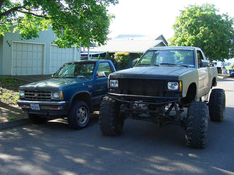

my truck next to the neighbors stock with a body lift 4x4. i dont think its that tall considering.

i've got a video uploading right now. it was the start of my rocks run, right as i ran out of gas. it turns out the gauge is broken or something, kinda a funny spot to run out of gas.

looks awesome! i cant wait to see the video!

The quick remove doors are pretty trick but for some reason it looses some of it's overall coolness factor with the doors on. But I'd still own it...and wheel it every chance I got.

Looks good. The removable door mod looks easy enough. I think Im just gonna take mine off and make some tube ones. My d-side door is still all messed up from the flop and its starting to piss me off.
And I'll definitely be boxing in my crossmember now
What happened?? Slip off a rock and land on it??

ok, here is one of the video's. i need to re-upload it though, my camera films in 16x10 and i forgot to letterbox it, and youtube compressed it to 4x3.
i ran out of gas at the end of the video

these rocks out here are huge, i dont even know when i damaged the crossmember, i only noticed it later. the winch was not mine, i was just borrowing it for last years trip.

That sucks you ran out of gas. That was a cool video.
