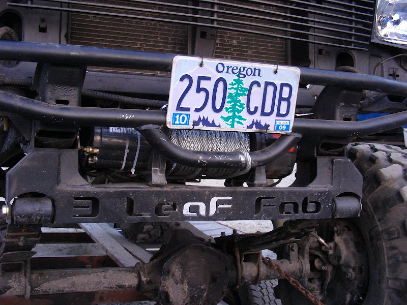

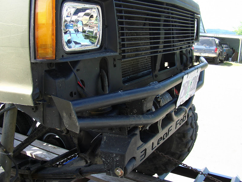

Hey Donahue can you get me some closer pictures of your front bumper? I want to do SOMETHING like that with mine but with square stock. Like how/where you mounted it. THANKS!
yeah, i can try and get some. its just welded right to the stock mounts. we did that in about 30 mins at midnight the night before we left for the rubicon.

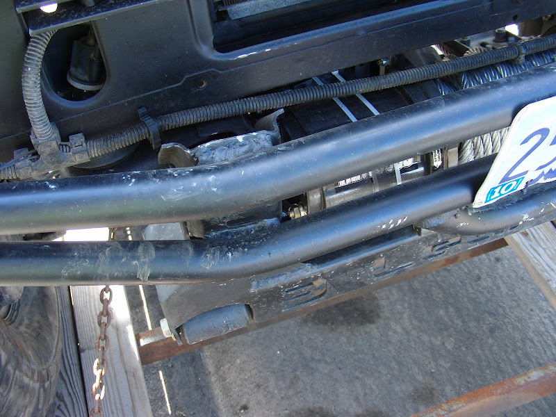

Re: 89 SFA buildup for rocks
does this work?
looks like the winch tweaked the front cross member a little?
yep
getting pulled by the winch line for a few miles of jerky, bouncy trail when i had to pull the rear driveline. we will be adding material back to the rear of the crossmember (thats where it tweaked) for the next ones we make.
