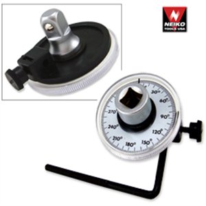

Does anyone have any idea how to use a torque to angle gauge. I got the el cheapo one from Autozone and I have no idea how to use it...Just like this one

you dont use angle gauges on arp!
you just set your wrench in place and use the lil arm to hold the base from turning. as you turn the wrench the needle should move and display the angle

Ohhh ok, I guess you have to be smarter then the tool lol. Well the rods don't have ARP bolts, they are stock. I torqued them to 50 until I could figure out how to use the torque to degree wheel... but I'll losen them torque them to 15 them 60 degrees.

Yeah the Torque angle gauge is a lil tricky IMO...I found out it works better with two people using it...I got my wife to help me. I would set it up and get her to hold the bar steady against the block/whatever and then double check..If you wrench has any "slack" in it get it to where you are just about to press forward with it and set the gauge to zero then in one smooth motion go to whatever degree it calls for...I'm no professional just saying what I found out worked best for me...Hopefully it's not wrong...haha
