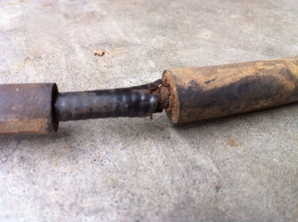

the cable should be easy to pull on, and you should be able to engage it by hand from there. get a buddy to spin the front driveshaft by hand in 2WD while you pull the cable. if its super hard to do or doesnt lock up, the cable could be frozen. i know mine was a tad rusty since the cable had a break in the outer protective cover.
cause...

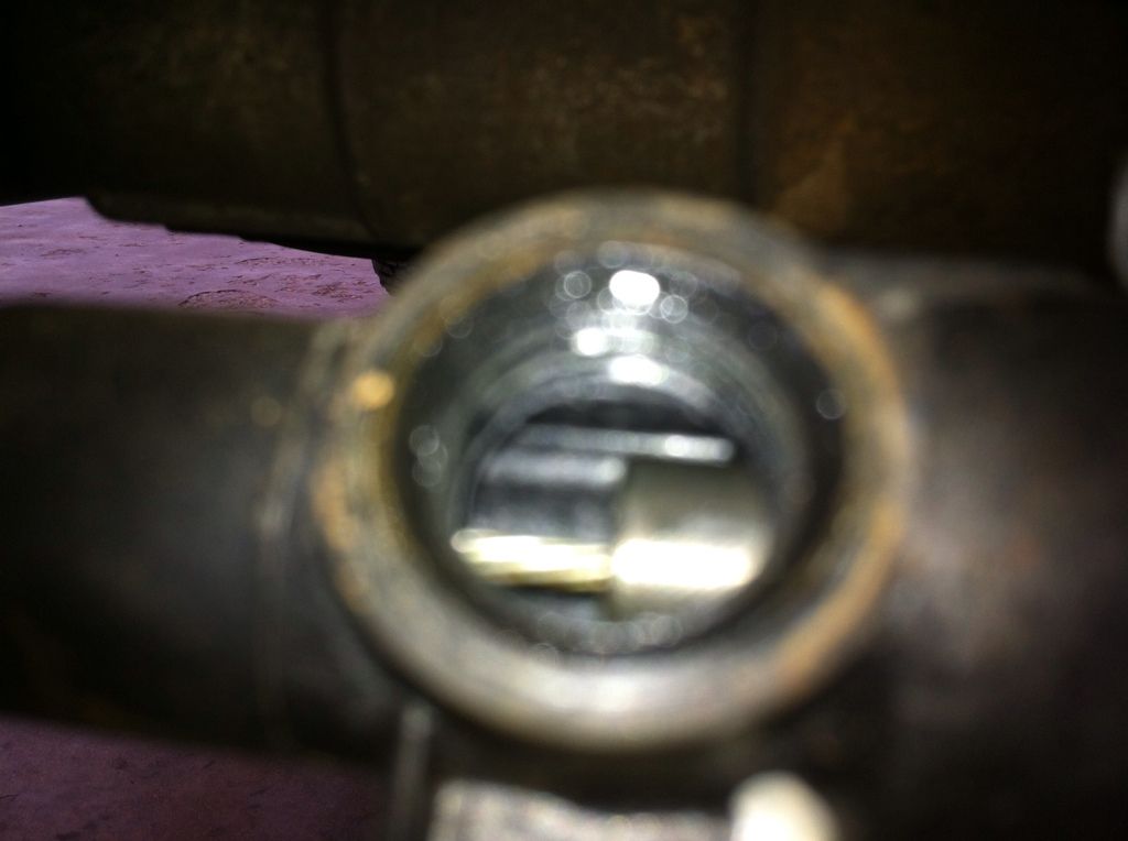

also you should be able to take off the little front axle sensor, and it should look like this when its engaged.
