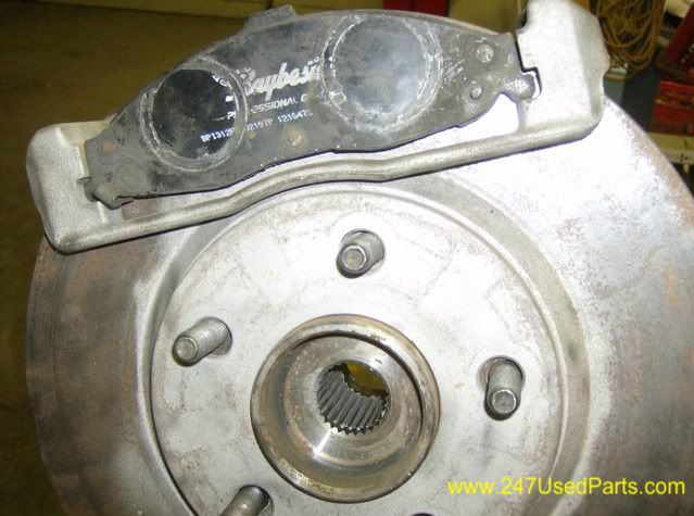

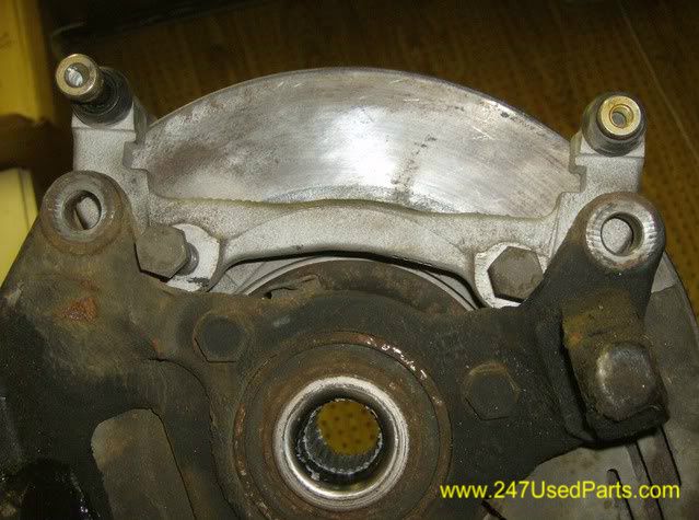

Originally Posted by Something Different View Post
I know this thread is is a little old but has anyone ever tried this swap on a 4wd truck with a stock blazer spindle & hub? Will this work on 4wd?
I have 2000 F-body calipers, rotors & pads. I also have '98+ 4wd spindles to install them on. I did a mock up and the caliper will fit fine with a simple adapter plate.
From the back side.
A simple flat bar with hole in the right places will span the gap between the Blazer caliper mounting holes and the F-body caliper mounting holes. I have the bar but it's not going to happen until this winter, still need the truck to drive for a couple of months.
The pads are the exact same size as C6. The pads are at least 50% bigger, and with a lighter 2 piston caliper.
You will need to deal with the placement of the brake hose. The F-body calipers put the hose connection at the bottom of the caliper. At full droop, suspension hanging, the fitting will hit the lower control arm at full lock. I've got a couple of ideas to work around this.
