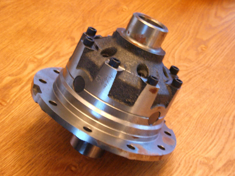

picked up a used locker but its missing one of the springs the clutches have between em? think i should call detroit and see if they can sell me just the springs? couldnt hurt to replace all 4 anyway.
i know lockright has spring rebuild kits for their lunchbox lockers because the springs and pins tend to break after a while. detroit might have the same thing. look on their website and see what they have in the way of rebuild kits
