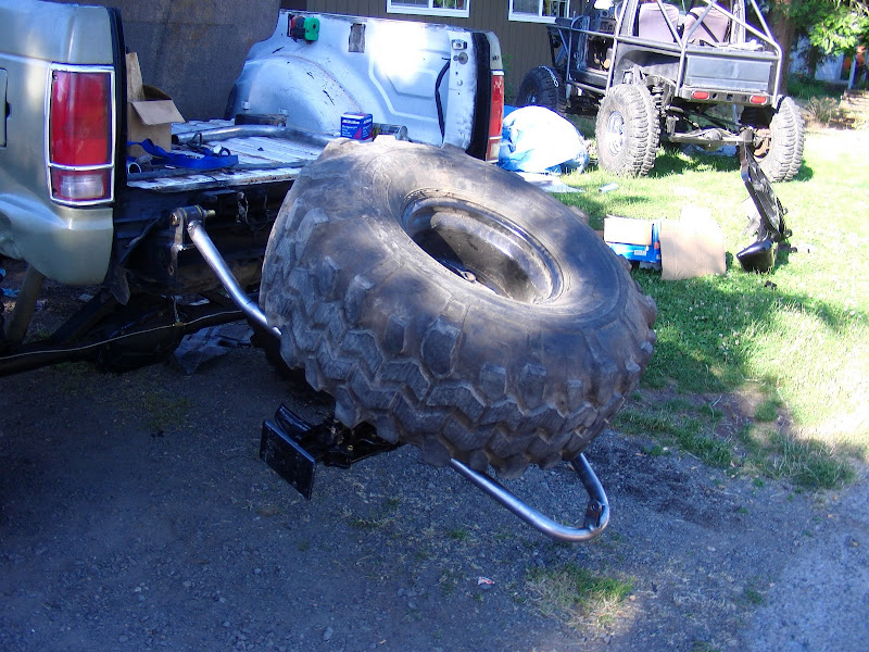

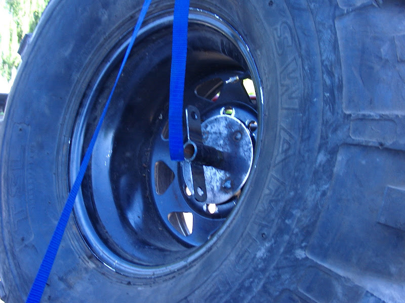

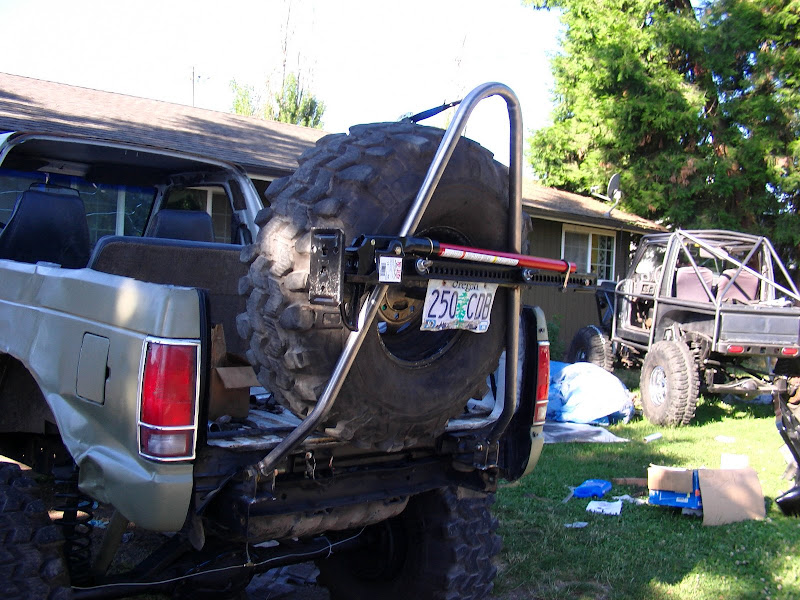

i was going to go with something similar to that, but i ended up making it hinge on the bottom edge instead of the side. it makes it pull straight down and not too the side. incidentally, when i put the tire on and off the carrier, its at knee level, not chest level. this helps because my tires are about 150 lbs each and hard to carry because they are big. a big wing nut captures the rim with the center hub hole, and not the lug holes. this makes it easier to line up. the pictures also dont show it, but the carrier will swing down until the hoop touches the ground. right now it ties into a little hook on the floor with a strap, but eventually, it will be integrated into the exo cage.
