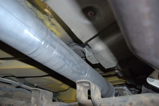

any one have pics of there drive shafts and notches in the cab?? thanks

I'm dropped 3-4" in the rear. The scratches on the driveshaft were from testing (too soft of a spring and shock combo) and occured under WOT, so it's probably a tad bit unbalanced.
Note the big-ass notch i had to put in the subframe and the hammered section of the rear cab. Also I had to cut the cab floor parallel to the driveshaft, directly above it.
I'm still having pinion angle issues, but the entire shaft weighs 17lbs vs. the 45lbs stock... I think it did more for power than pulleys, intake, or headers (mmm rotational inertia) but was offset by my wheels .
oh and the notch is an old section of pipe that I cut up
