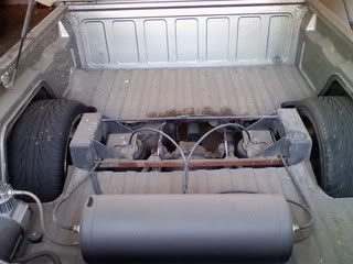

New to the forums and have been looking around for a little while trying to find a decent s10 to work on in the upcoming months. I think I came across the right deal but the previous owner seems to know nothing about the truck or he's hoping I don't come and notice a lot of things wrong with it. When it comes to vehicles in general I know whats going on mechanically but know nothing about bag set-ups. He says it is bagged at all corners and does have a link set-up in the rear but no idea what one (2/3/4 link etc). From searching I have figured out the different links that it could be so that shouldn't be hard to notice. He did say some of the welding is done poorly but the thing that gets me is he says the truck isn't notched. So far I have only seen some poor pics of the truck and been trying for the past 2wks to see it in person but our timing has been pretty crappy with working and such. If the rear isn't notched than how much welding could of really been done that wouldn't be easy to fix?
Lastly, in one of the pics is shows the bed of the truck where its cut out and to me it looks like its notched, am I wrong? I also can't see any type of link set-up. I don't see any bar runs anywhere.
Sorry for the small pic but thats what I was sent when first contacting the seller. What are basic points I should pay most attention to once I get to look at it up close.

New to the forums and have been looking around for a little while trying to find a decent s10 to work on in the upcoming months. I think I came across the right deal but the previous owner seems to know nothing about the truck or he's hoping I don't come and notice a lot of things wrong with it. When it comes to vehicle in general I know whats going on mechanically but know nothing about bag set-ups. He says it is bagged at all corners and does have a link set-up in the rear but no idea what one. From searching I have figured out the different links that it could be so that should be hard to notice. He did say some of the welding is done poorly but the thing that gets me is he says the truck isn't notched. So far I have only seen some poor pics of the truck and been trying for the past 2wks to see it in person but our timing has been pretty crappy with working and such. If the rear isn't notched than how much welding could of really been done that wouldn't be easy to fix?
from the pic, it does have a notch

Thats what I kept saying to the seller and he keeps telling me it isn't notched. I admit I don't know much about air ride set-ups but I'm pretty sure I know a notch when I see one.

maybe im wrong but it DOES have a notch but the way the bag brackets are, the only purpose it's serving is a place to weld the gussets for the brackets...

WHat does that mean in regards to how the bags are mounted? The gussets are for extra support but does that say anything about the set-up as it sits?
What should I look at and focus on the most when looking up close at the s10? Obviously the welds but what should I really look for in them to make sure they are structurally sound?

Looks like a BOA reverse 4-link(?) since the stock fuel tank is still present & there is no link bar on the top.

It could very well be mono-leafed, thats way more common than a reverse 4link. Yes it is notched and its not just for the bags, you can probably lay 20s with the size of that notch. Everything I can see in the pic is home made. If you can weld, then there isnt that much done to it that can be bad. Even so, its just metal, it can be fixed.

the bags look to be over the axle, doesn't a reverse 4 link mount back more?

What the guy with the playboy avatar was saying, is that the bags are sitting so low, that it looks like the are fully collapsed in the pic, but the axel isnt even using the notch. The back could be moved up higher. When you look at it, just have a decent camera phone, or a normal camera on ya and snap a bunch of pics under the rear of the truck both front and rear. Then come back in here and post em up.

either put a battery in it or jump it.
Problem there is it doesn't hold coolant, can i run cables off my truck for a little to send juice to the compressor and allow it to air up so i can get this thing loaded on the trailer?

yea as long as the keys on it shoudl run the air compressors thats the way iv seen it, and how my truck is. alone the rims are porbably worth 1200. but did you notce how the focker ran the brake lines along the differential?

btw if you cant air it up and there is no air in the bags its not verry close to laying out. one picture looks like its still 3 or 4 inches high

All that will be getting re-done anyway, a lot of stuff was just taped up or hanging. Not to worried about it at this point.

damn for 1200? Its probably worth it then. The back of the notch looks a little iffy though.

id buy it for 1200 and just sd backhalf if. notch looks scary, some of it looks decent.
rear body work is piss poor, but it can all be fixed. and go slap a battery in it and see if it runs, you don't need all the antifreeze in it to run it, just dont let it get too hot.
when i put my motor in i ran it for 5 mins with no radiator or coolant in it at all, didn't hurt anything

good buy for 1200... I take everything back except about the rear setup... You say the shock mounts are crappy so they're worthless, needs a better notch than that, bags look a little crooked, and it looks like the front tabs on the upper bar is welded to iron. I hear thats a HUGE no no... so yea.... it would probably save a lot of time and trouble by getting the backhalf. Unless you have the time and effort to fix it then go for it...

Personally I would rather start from scratch than take over someone else's busted down rig. Yes, you may spend more doing so, but it will be all your doing and you'll know how it was done.
Start from zero. I consider that truck starting in the negative. just my opinion.
If he didn't even know it was notched...what does that say about the PO?

Plenty of times have I bought a something that the PO doesn't know whats going on, thats why i came here first. I too like to also start things from the beginning but if I can be ahead of the game a little that works for me, sometimes you just need to learn the hard way. Right now lets say I have to do the back half, its some decent $$$ but after that it will be pretty good. If I start from scratch, I will need to do the same thing in doing the rear, only next I have to buy rims, cover, lines, fronts, etc. If it isn't what I want it to be I will part out the nice stuff and set majority of it back to stock and sell it for what i paid and still have made some money from the aftermarket parts. We'll see how it goes I guess.

Ya the upper 4link bars are welded to the cast center section and while it can be welded correctly, most people dont possess the skillset to do it right so its generally considered a big thing not to do. You can just put a SD 3link or 5link in there and be set. The skin should have got bracing across it to keep it from cracking, it will need to be cut out. The compressor and valves are shit from AIM so you may want to change them in the future. To air it up, just put a battery in it or jump it, the fact that theres no coolant in it doesnt mean anything unless you try to start it. Also it sounds like a freezeout plug let go, you can hope its just a hose because thats way easier to repair.

buy it, scrap everything from the c notch back and all the air ride, rebuild/replace it. should be golden. id buy it. the only thing that does bother me is the whole engine thing

Kind of funny cause the motor is really the least of my worries, if its shot I will most likely do a 350 transplant but if its something pretty minor to fix i will run it the way it is for now. Thanks for all the replies so far guys, this forum is def a place of knowledge and so far good people!

Got a little update: I am passing this dime. Drove over with a trailer ready to take on a new project and it just seemed to get worse and worse the longer I was there. The front wouldn't air up at all, the spring pockets were so small I am not sure how the bags even got in them, of course the bags were worn through hense the no lift. Driver side tire was completely down to wire on the inside tread, not sure how it held air. I did get the motor to fire up, fan clutch bearing shot to hell from what it sounded like and what i could see with the nice wobble. Figured ok lets just drive it up on the car carrier, no gears, just neutral. Added to everything else mentioned I backed off. Truck had a NV title so it would be a PITA to level 1 it here in AZ unless I haul it to the DMV, story from the kid changed a little and the truck was sitting for roughly six months so about the only good thing going on with the truck was the cab area. He even offered to take less and that threw up another flag, 2g's down to $1200 and now even less. If anyone else maybe looking for a project I will provide his info but this was more than I am looking for right now.
