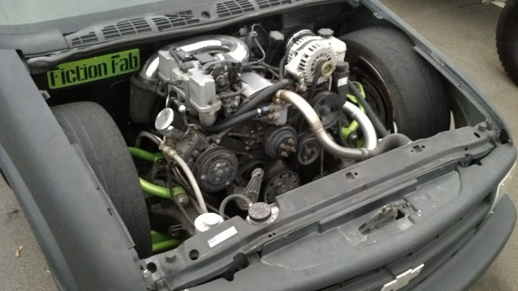

Here's what I came up with on mine to fit under the stock hood(before the bodydrop). Moved the alternator to the top and put the 209 where the alternator was. The alternator is also off of a fullsize, so that's why it might look big.

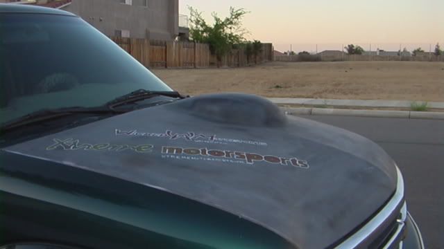

when I posted in here i actually thought of you.. and the bubble hood
Edit: getting to your fill plug for oiling must be a BITCH!! But im sure you developed some kind of breather/fill tube for the right side of the comp/fill plug for better access right...

Yep. That lil shiny dot right next to the compressors filter is my fill tube. Its just a 3/8 hard line that threads into the compressor and has a threaded cap. I have never vented my compressor though

I miss the bubble

I see it. I did pretty much the same thing without the hardline. Tapped mine to 3/8" NPT and used a 3/8" ptc fitting and some fuel hose and added a tiny breather to it. Using brake line like ive seen some others do was just not going to happen and its too small to let the compressor breathe IMO. The 3/8" fuel line had a decent enough opening enough for me to add my breather but Id love to get hardline and do what youve done..
Some never vent them and never have problems, some have nightmares. Guess youre one of the lucky ones lol
