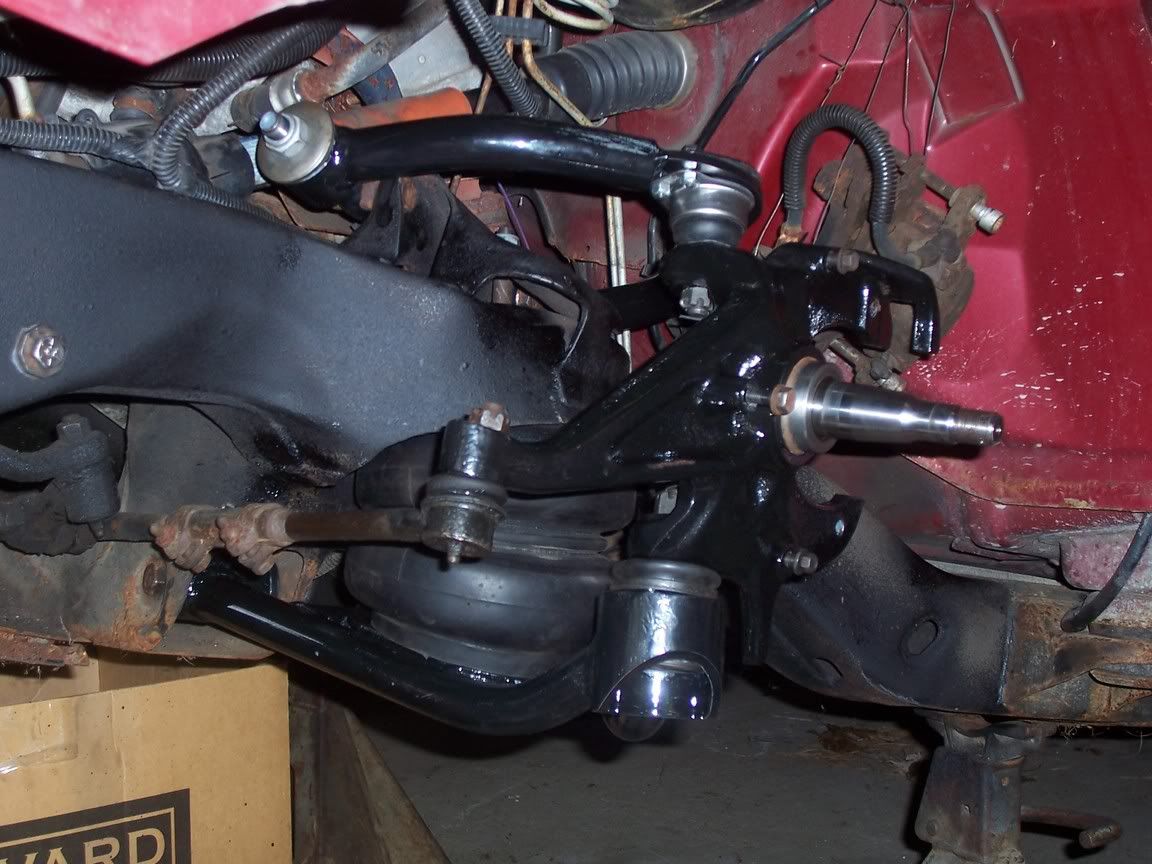

Here are a few pics of when I put in my 2600's

Here are a few of my Truck. 98 S10 BYC upper and lowers, Slam RS72. 2" top cup offset 3/4"
None of you guys have any problems with your frames cutting up so high? I even see some cut one of the upper control arm mounts right off. I cut that from the frame, then heated and flared my spring pocket out as much as i can, trimmed some of the pocket, then flared more. I have alot more pics if anyone needs them.

the last picture shows my tie rod notch.. but you can see the bag in there.. I cut alittle to much.. so I ended up making a new plate.. Looks like it would if was factory.. just little stronger
its a Slam RE 72... or maybe rs .. i can't rerember.. i know its the 7 series
the first 2 pics are with my stock arms... i cut just alittle more with my ART arms
i had cups made.. offset 1/2'' ... i just offset the whole cup. i dind't move any bolt holes or antying.. it is 2.5'' tall to

why the offset on the cup??????

Re: 2600 224c 2b7 slam rs72 es72 hs72 bag s10 front install pics
to bring the bag away from the inner lip of the spring pocket
I offset my cup a 1/2" to make sure i didnt rub the fuel lines that run through the frame on the drivers side.
any sugestions on how to do this with SD bolt in cups?
All i did with mine was measure over 1/2" from the slots then drill 2 holes where the bag mounts. Then i needed to oblong the hole for the fitting.
dont have pics but i offset my re7s by about 1/2 in. with the sd cups.

Question Re: 2600 224c 2b7 slam rs72 es72 hs72 bag s10 front install pics
Do you have to offset the 2600 (re-7) 1/2" as pictured below to fit in the front spring pocket? I've heard yes and no
i had t ooffset my re-7.
but i didnt have to hack up the cups though.
the sd cups already have slotted bolt holes and slotted air line hole.
so it slides over perfectly that half inch you need.
