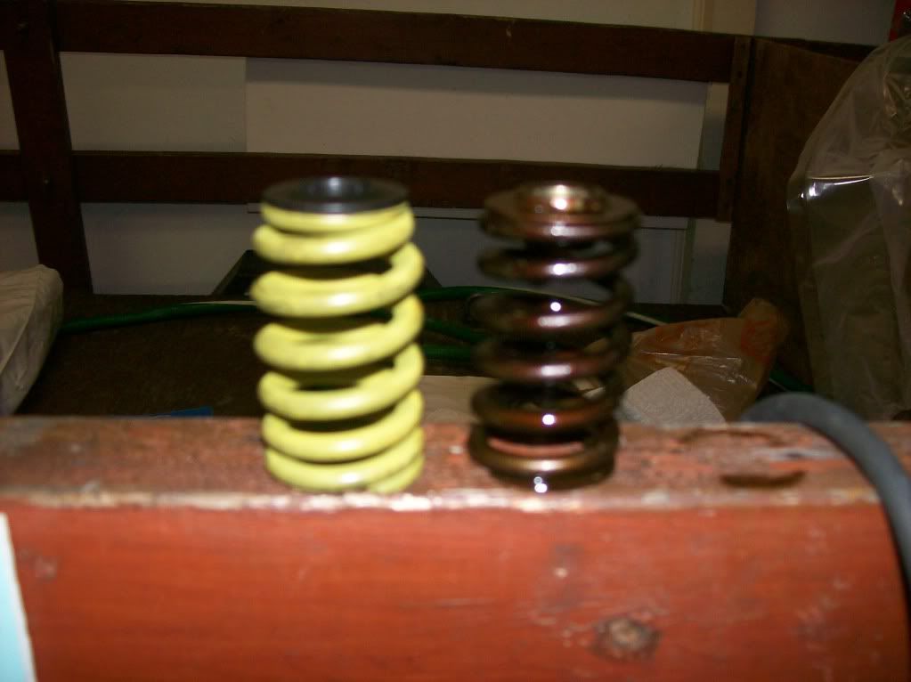

Valve Springs...The Ls6 beehive valve springs are found cheapest on ebay through lingenferter($58.26)

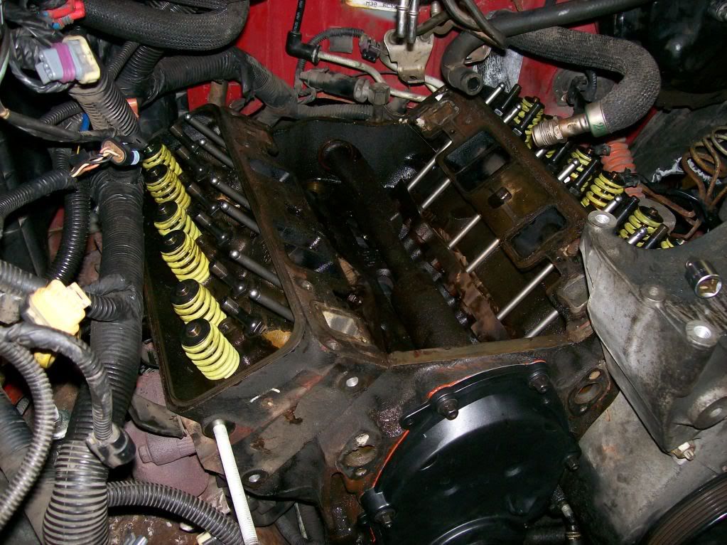

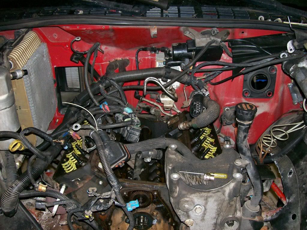

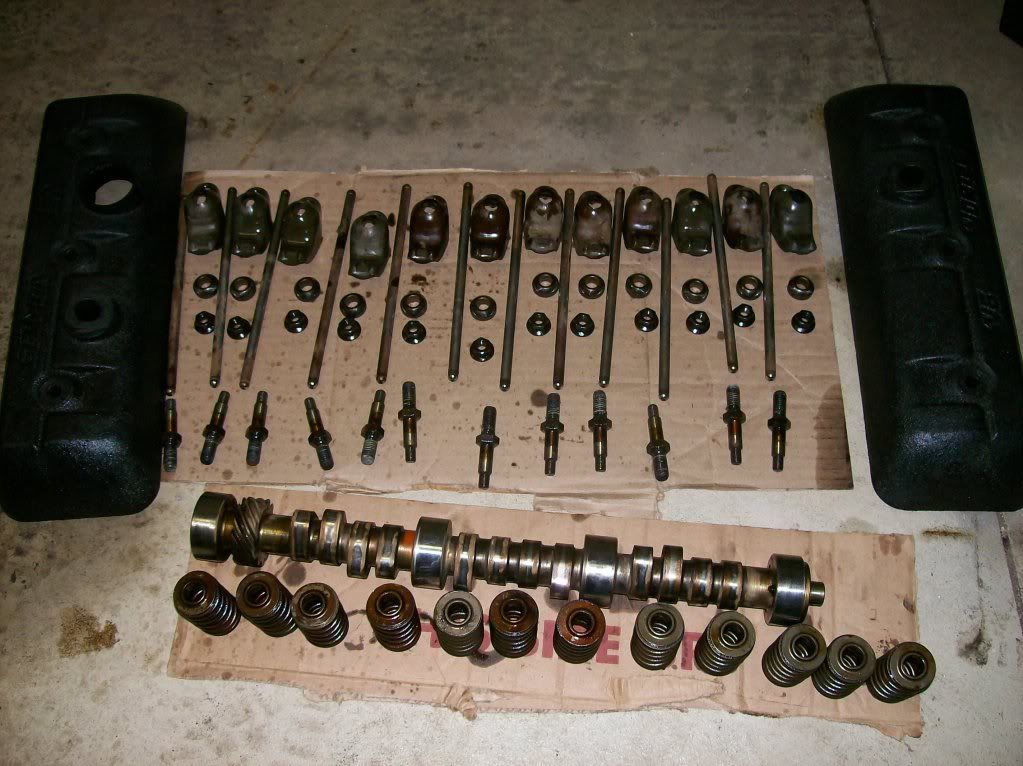

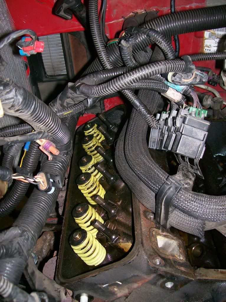

Well we started on my truck at about 3:00 pm and we called it quits at about 1:15 am. As far as progress goes we dissassembled everything except the stock springs and we havent taken out the stock camshaft. We will pick up on that tomorrow. Here are the pics of how everything looks so far!!
^^YOU GOTTA LOVE THAT DEXCOOL!!
Basically all of my stock engine components will be for sale as parts or as a whole whovever wants whatever. Just make me an offer. Its all in good shape and im cleaning them up tomorrow. As for tomorrow we will see how far we can get. Maybe get it all almost finished up. We took a video of how the truck sounded before and well make a bunch of videos of how it sounds after. And how it runs hehe!! I know the lower intake manifold gaskets are notorious for leaking and we will probably pick one up from summit tomorrow. What kind is most recommended, meaning like material or brand. The kind i was looking at is FPP-1202 on the summit website for like 20 bucks. So thanks for all the help and info along the way guys and we will keep the pics and the info coming. Hopefully we will finish it up asap and get some cam videos!!
