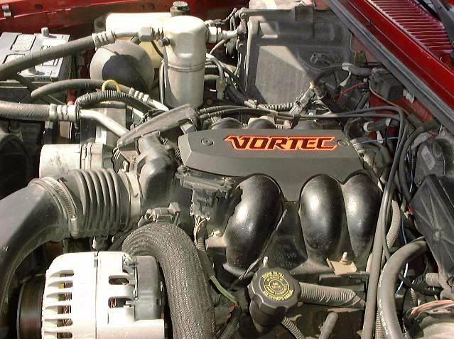

In 1992, Gm started building the CPI motor with "Vortec" on the intake manifold cover:
The heads were changed in '92 but then in '93 they were changed again for 10% more airflow. About this time, GM started putting "Vortec" on all valve covers, CPI and TBI. Here is a description of those changes:

that looks like my eng exept all my intake is gray.
