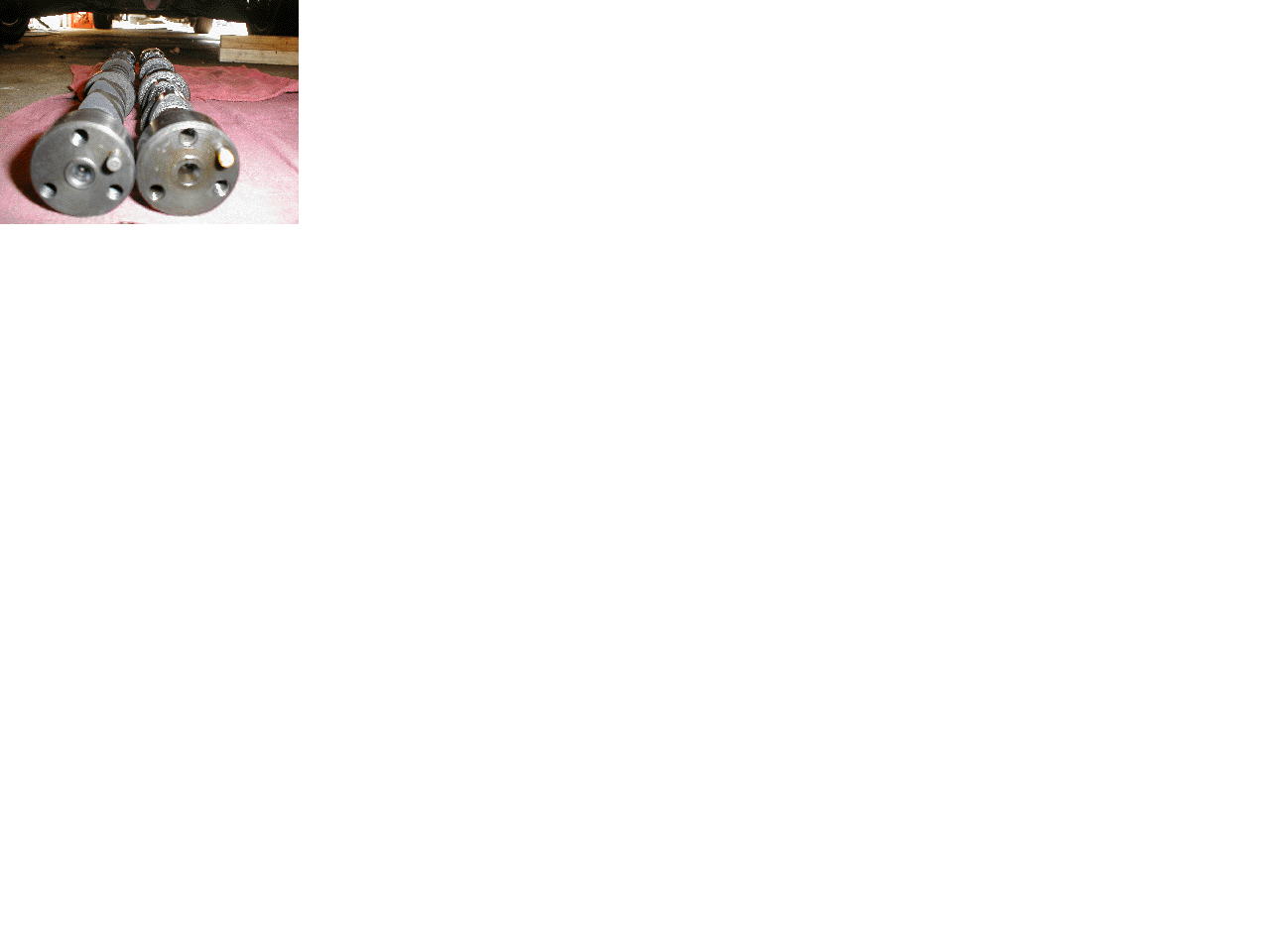

i've got a comp cam that is pretty big and should add some power. it took me 3 hours to get to my cam. not too bad for not having a clue. edlbrock makes headers for $200 at summit.

COMPETITION CAMS CAMSHAFT SPECIFICATION SHEET
PART # 16-233-4
GRIND NUMBER: CSV-6 260H-10
ENGINE: CHEV. 60 DEGREE V-6
INTAKE EXHAUST
VALVE ADJUSTMENT HYD HYD
GROSS VALVE LIFT .440 .440
.006 TAPPET LIFT 260 260
VALVE TIMING OPEN CLOSE
AT .006 INT 24 BTDC 56 ABDC
EXH 64 BBDC 16 ATDC
the headers are shorty,, but go into a Y and down to the cat. they have plug ins for the air pump,oxygen valve etc. an easy bolt on part edl-3116 at summit. the cam is supposed to add 20-30 hp depending on mods.
